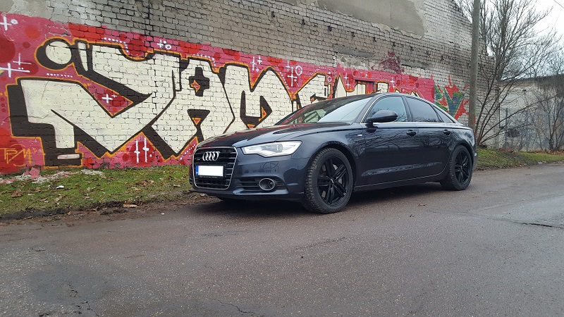

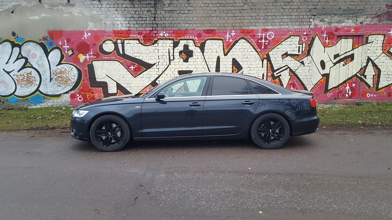

Leidsin kena graffiti seina.
https://www.upload.ee/image/6560739/20161222_104715.jpg
https://www.upload.ee/image/6560745/20161222_104804.jpg
