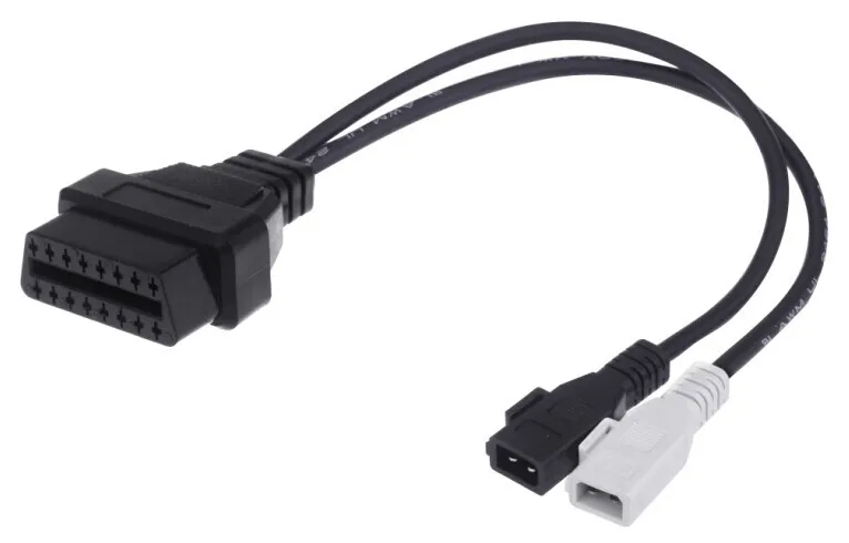

Ehk reeglina vaja ka:
https://ae01.alicdn.com/kf/HTB1h209KFXXXXc0XVXXq6xXFXXX1/2-2-16Pin-OBD2-font-b-USB-b-font-Car-font-b-Adapter-b-font-Cable.jpg

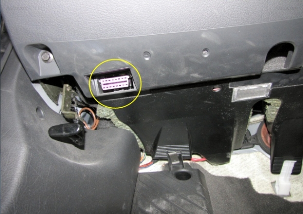

Minu viga, 2.4 muidugi C5 kerel...
https://www.upload.ee/image/6353461/Clipboard02.jpg
