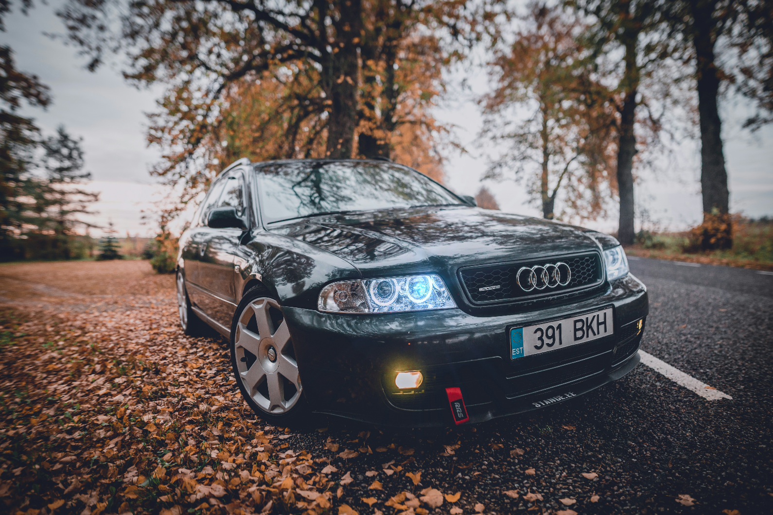

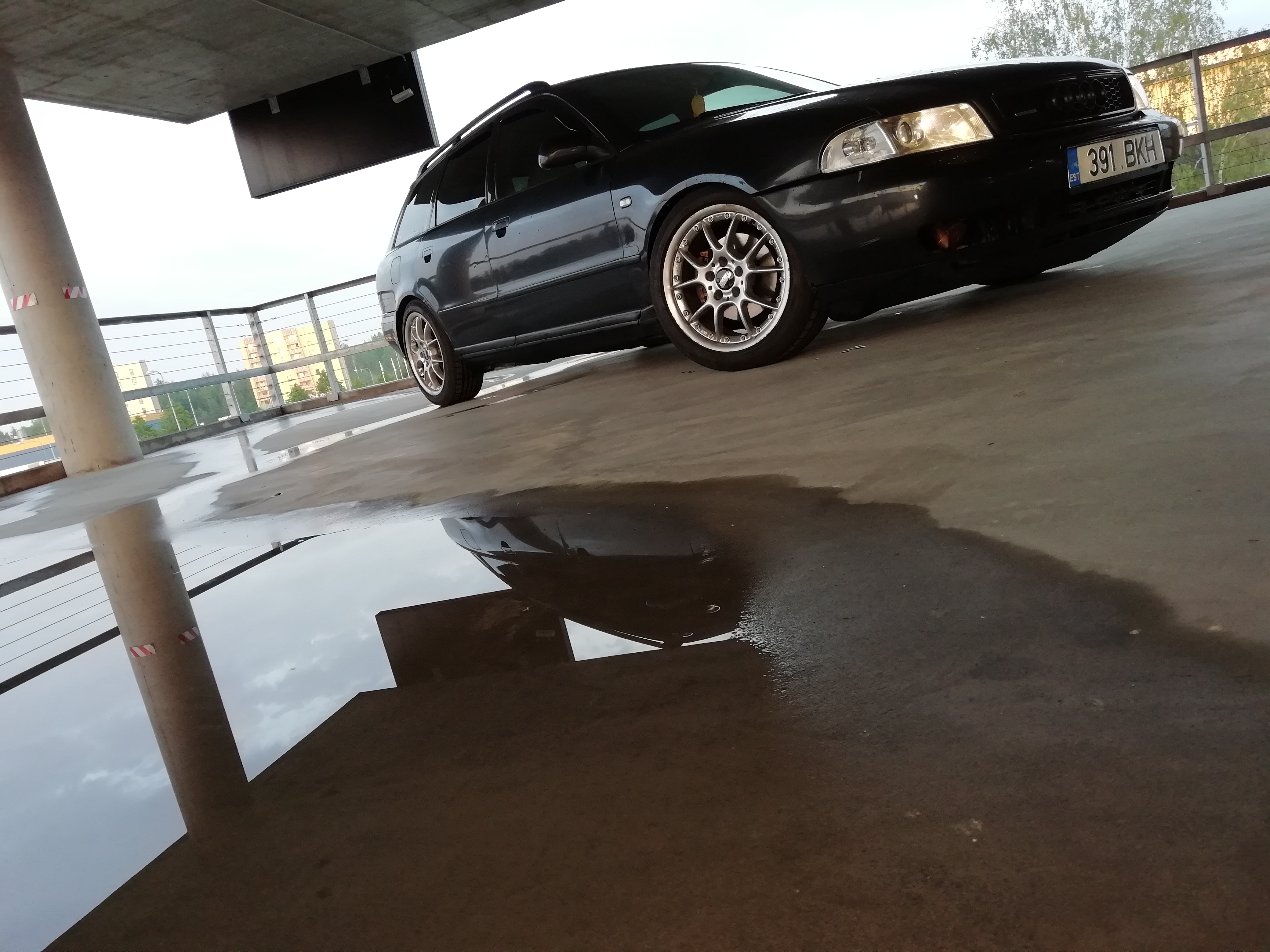

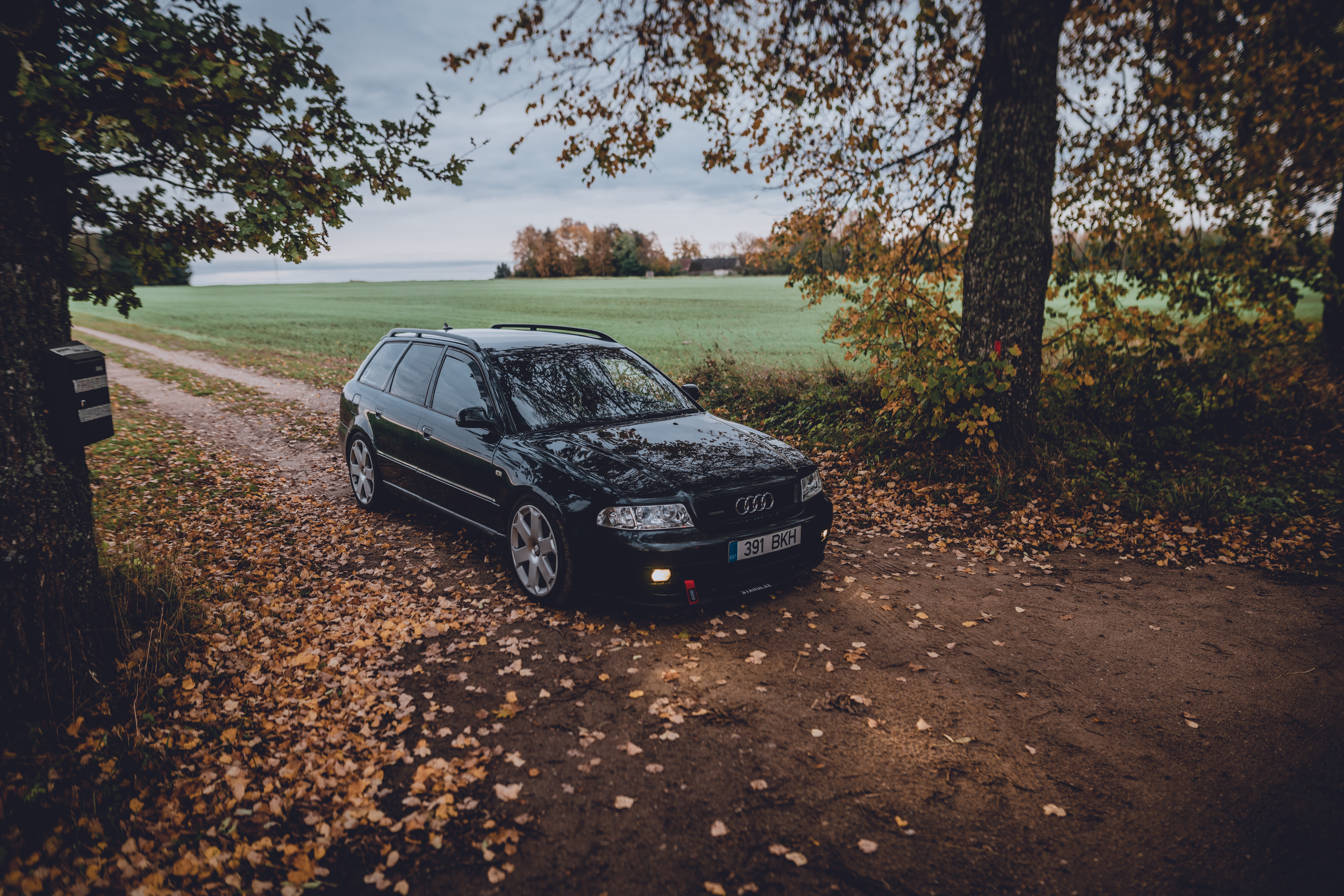

Pilte ka siis natukene, et oleks pilt selge, millega tegu

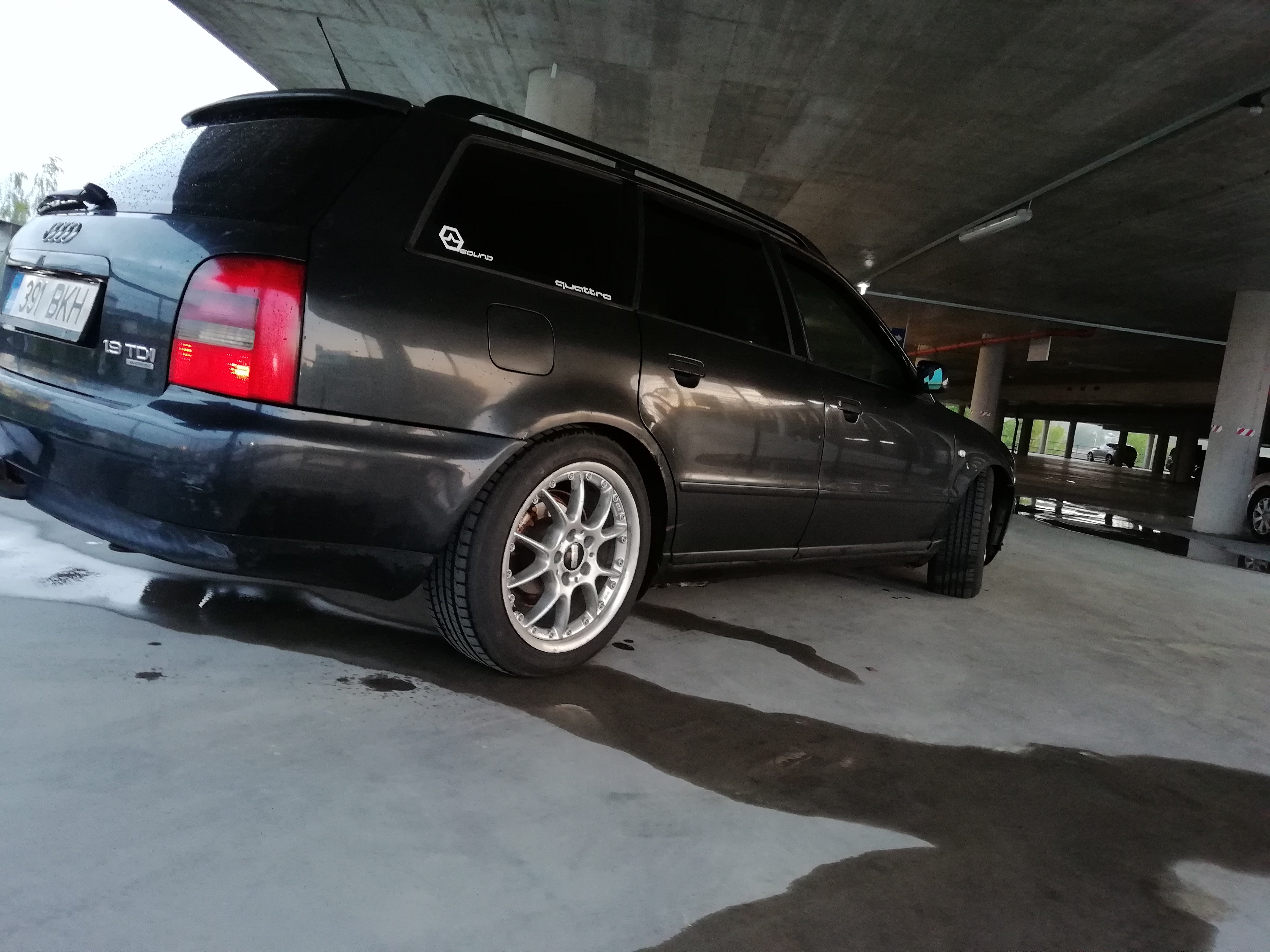

Suht alguses
https://www.upload.ee/thumb/13004145/IMG_20190524_212108.jpghttps://www.upload.ee/thumb/13004146/IMG_20190524_212119.jpg

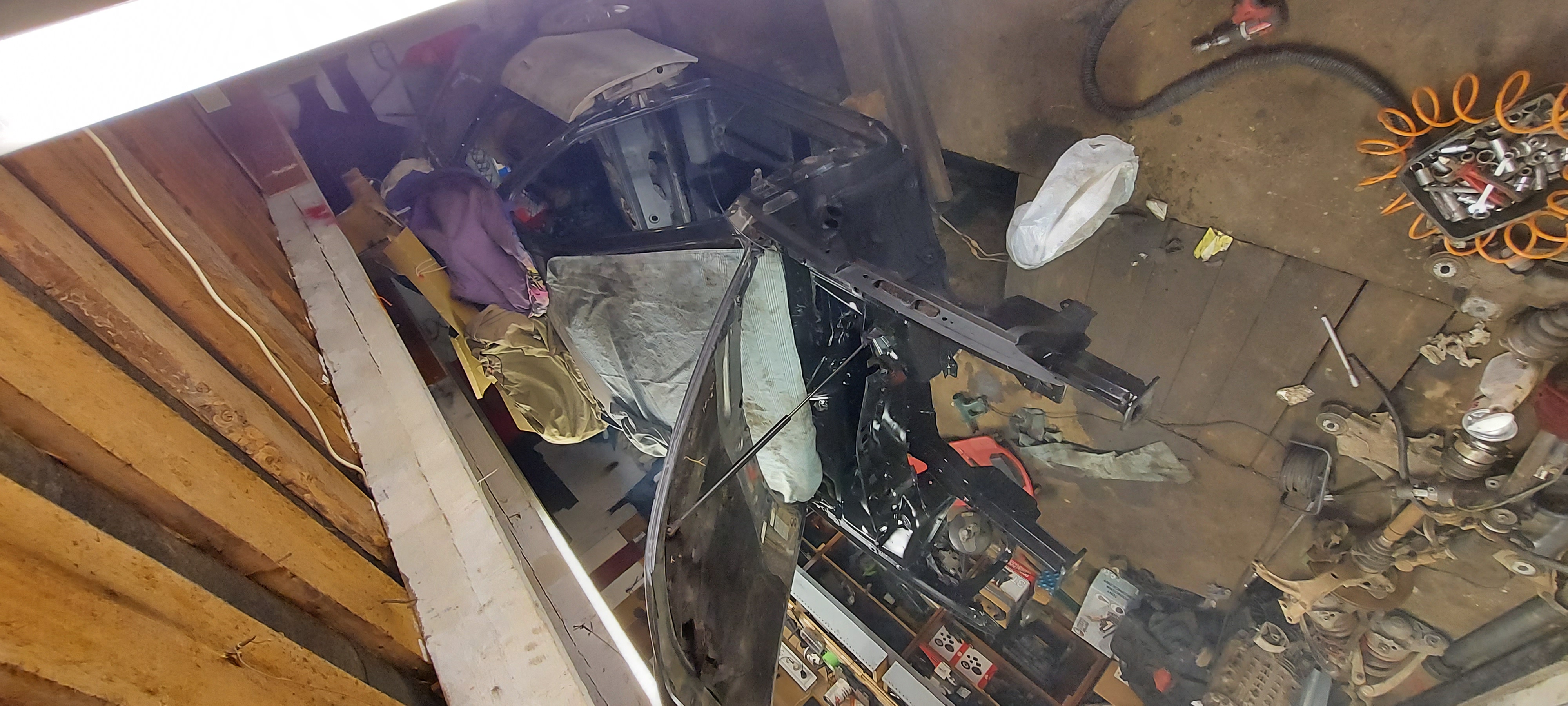

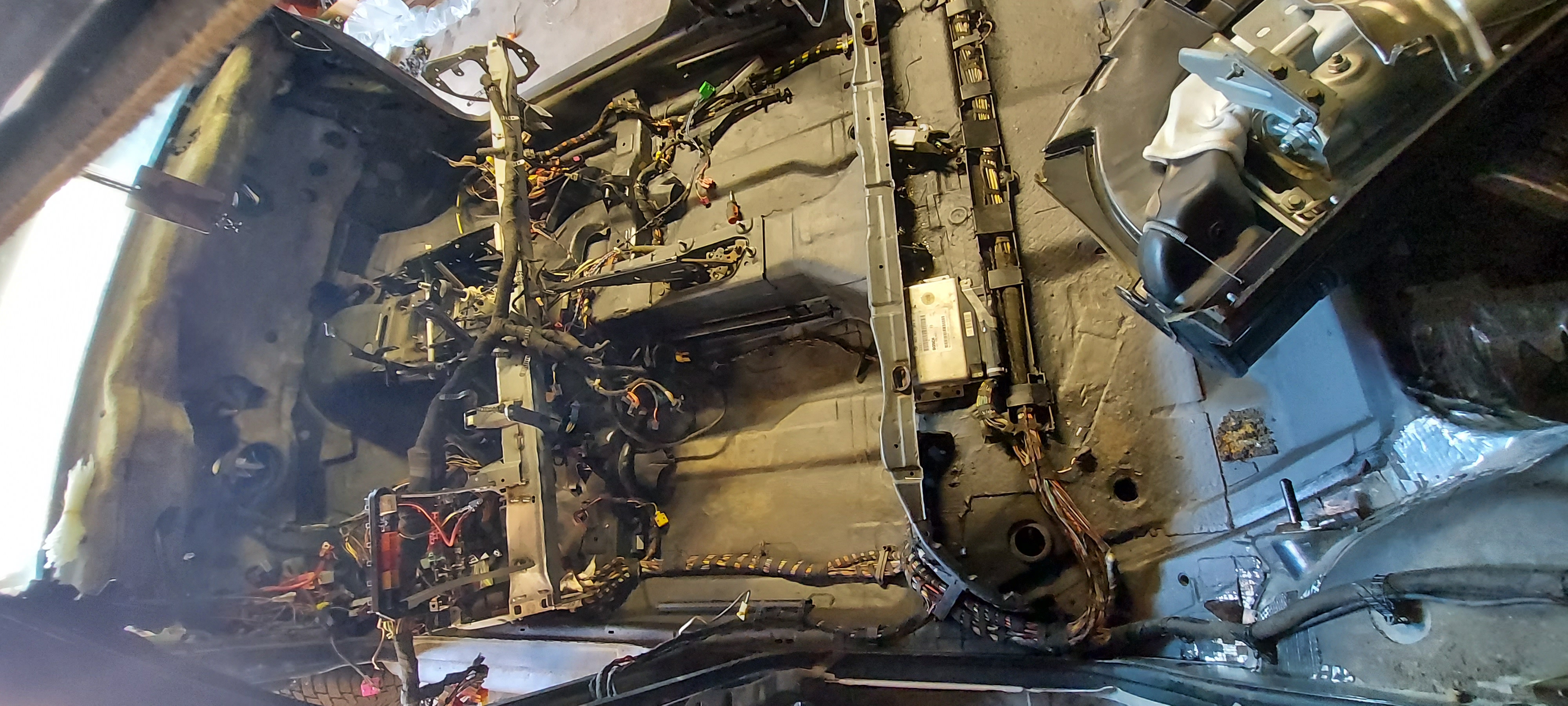

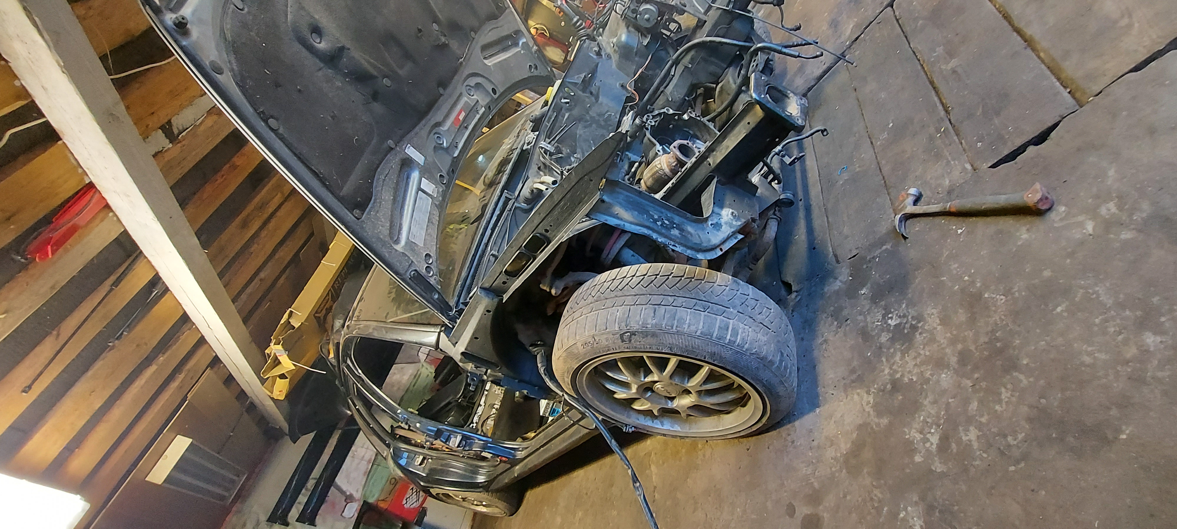

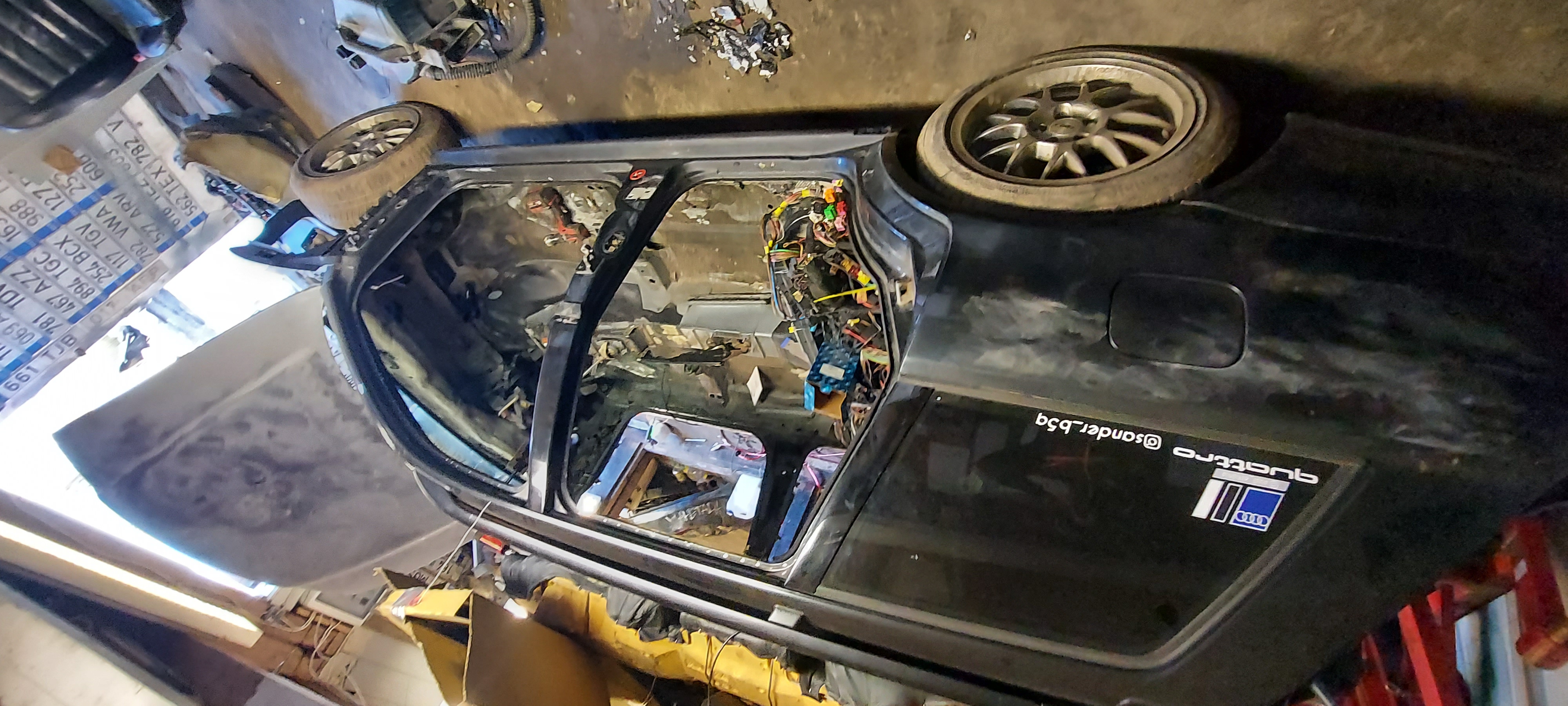

Ennem laiali võtmist
https://www.upload.ee/thumb/13004148/20210112_194105.jpghttps://www.upload.ee/thumb/13004149/20210112_194029.jpghttps://www.upload.ee/thumb/13004152/Glaneli_fotokunst-82.jpg

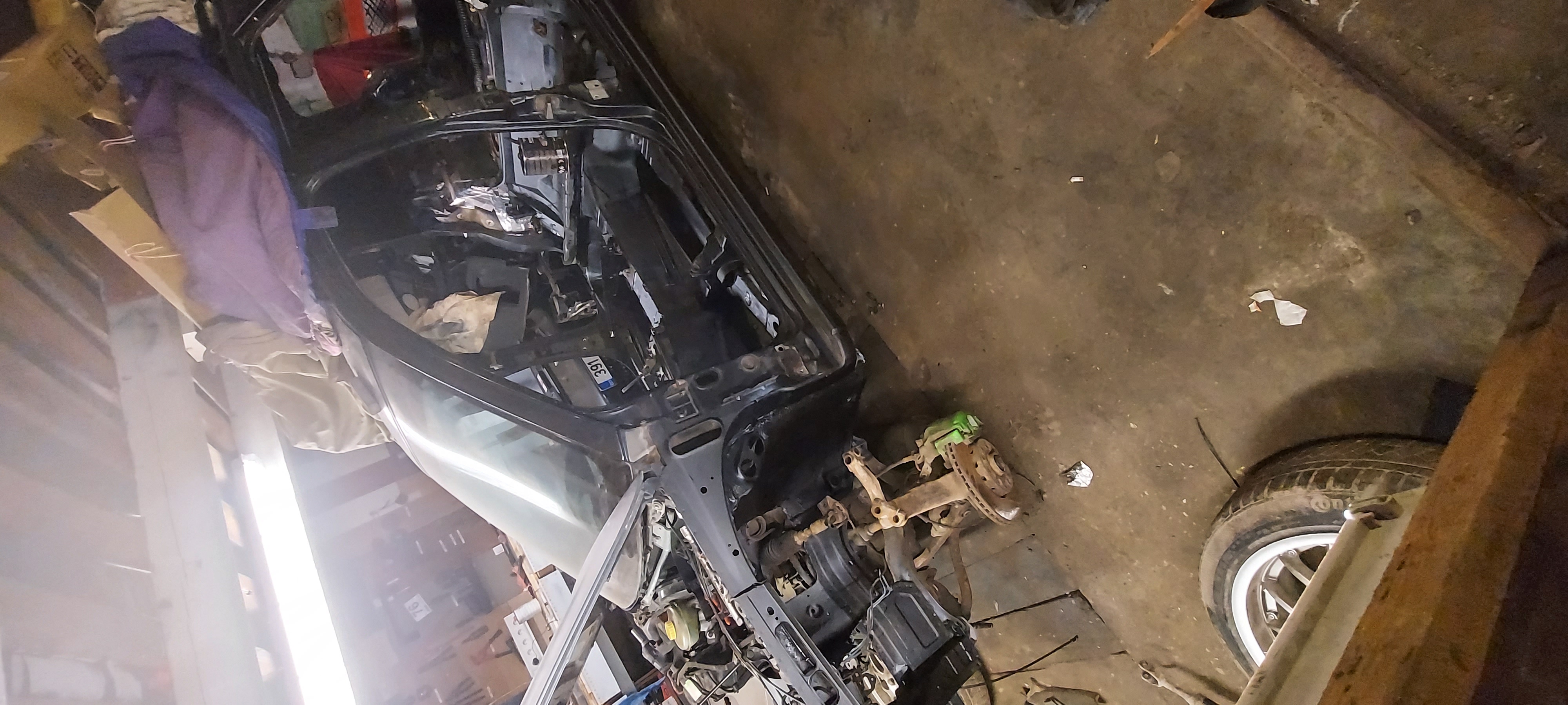

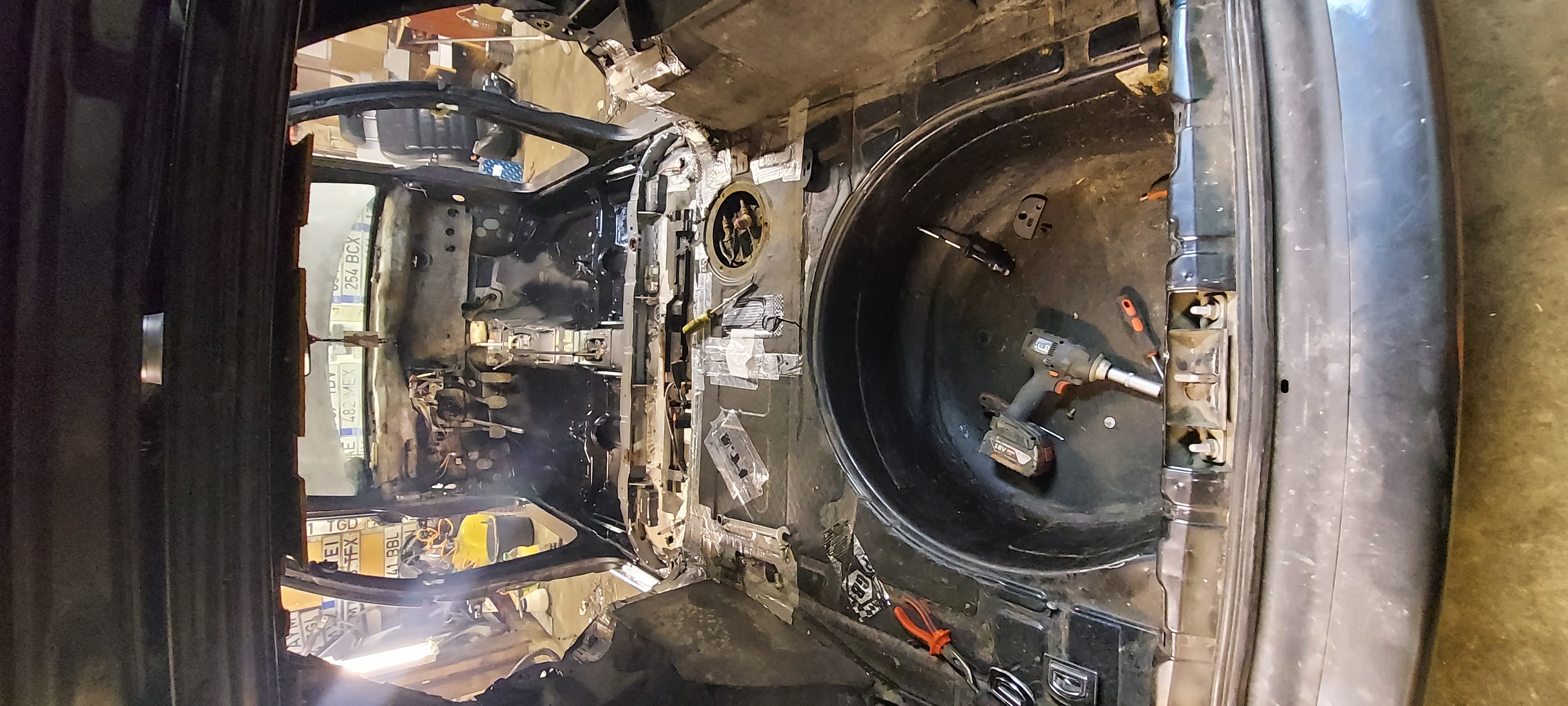

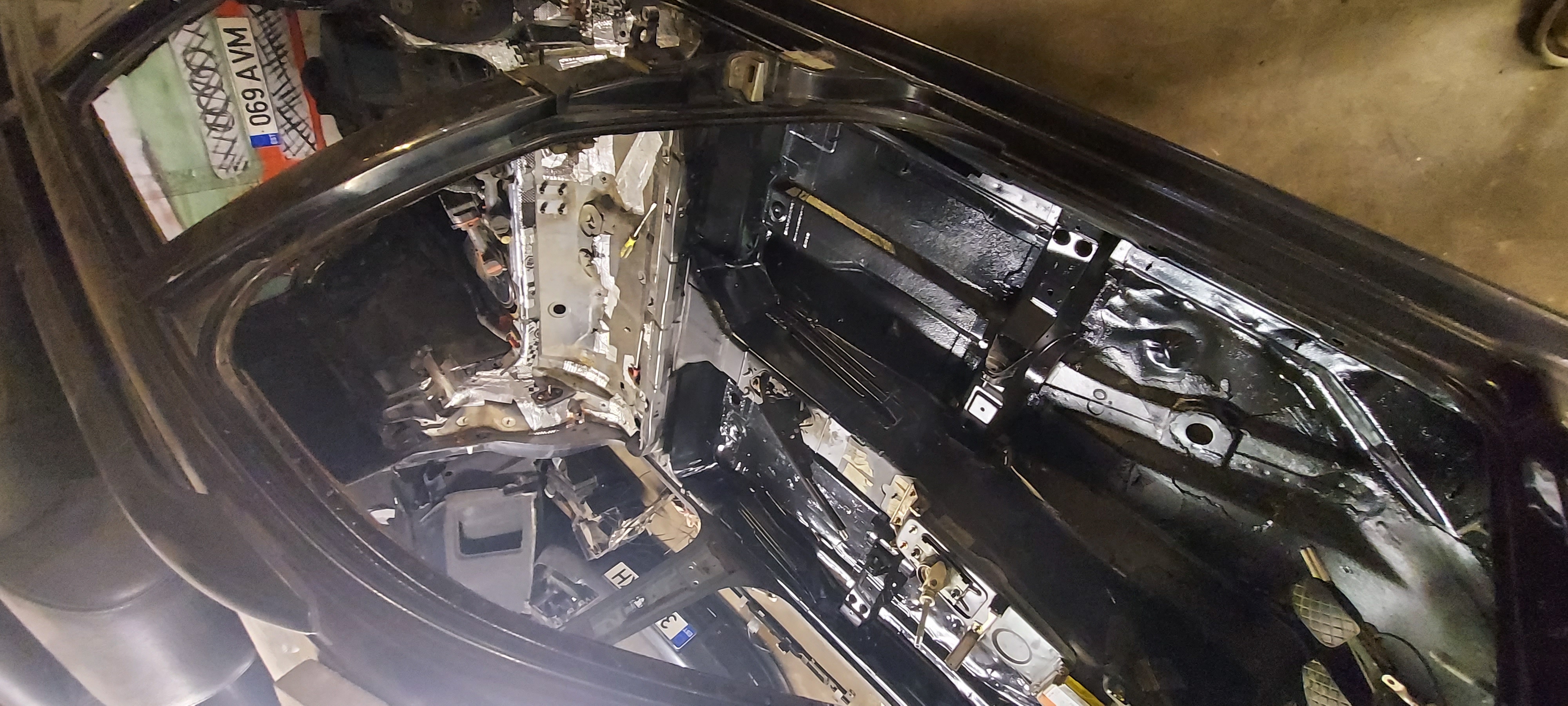

Hetke seis
https://www.upload.ee/thumb/13004153/20210327_180641.jpghttps://www.upload.ee/thumb/13004155/20210328_171143.jpghttps://www.upload.ee/thumb/13004157/20210329_010456.jpghttps://www.upload.ee/thumb/13004158/20210329_001401.jpg
