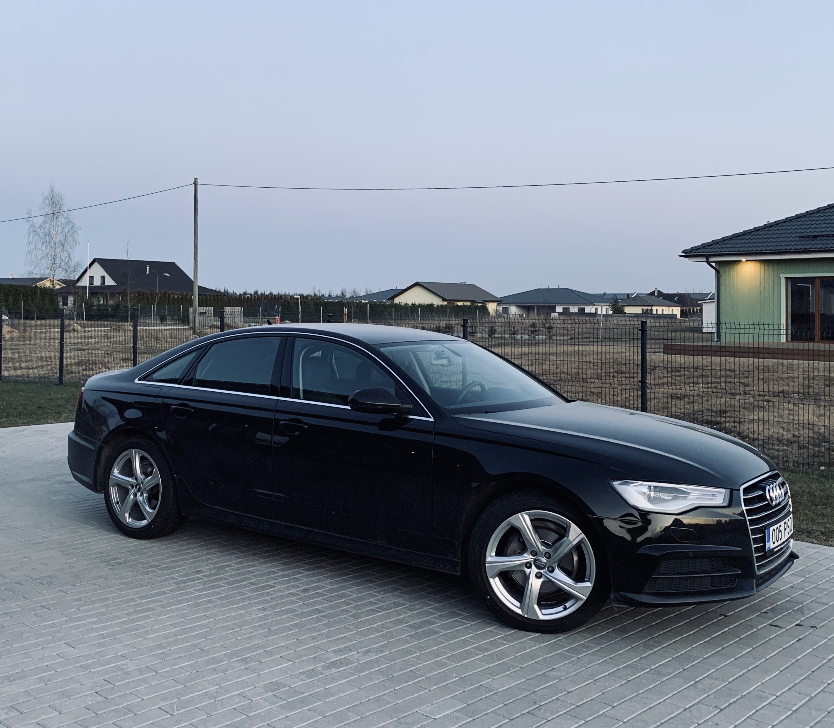

postitati 27.03.20 20:36 Tsiteeri
Lubatud pilt
https://www.upload.ee/thumb/11352635/AB62CBC9-9439-4035-A9B0-7805731CE204.jpeg
