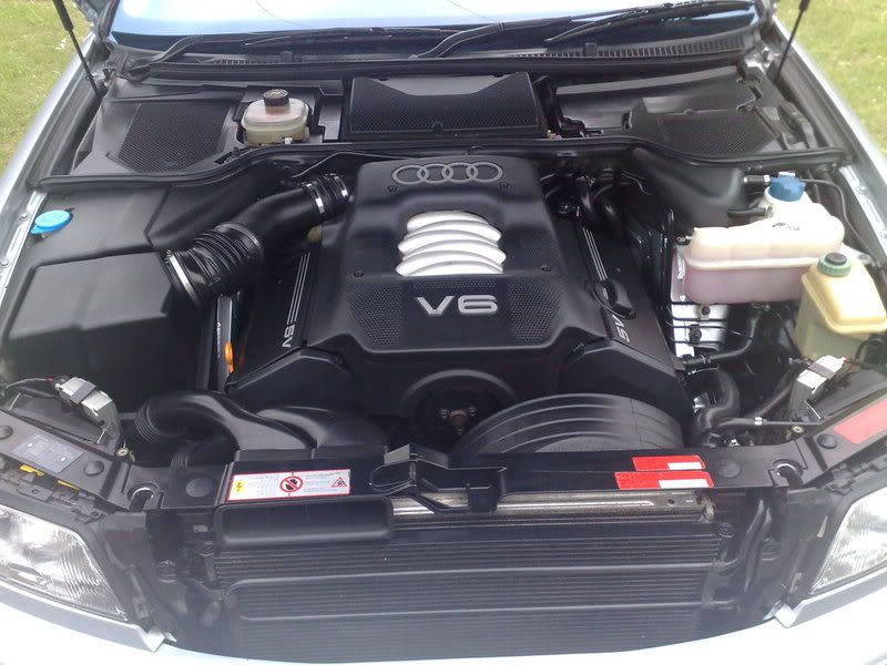

Kommutaatorid peaksid leidma pildil sinise korgiga tuvastatava katte (aknapesupaagi kork) eemaldamisel.
http://i148.photobucket.com/albums/s37/Ska_pics/02062008085.jpg
Sarnane see jubin peaks seal olema:
http://acimg.auctivacommerce.com/imgdata/0/0/9/8/8/5/webimg/1648289.jpg
